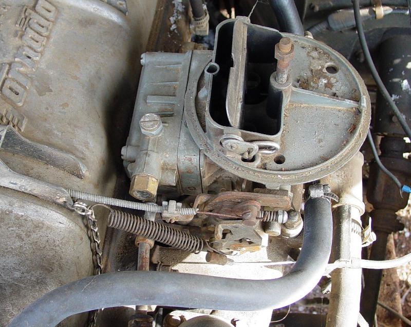

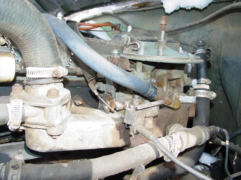

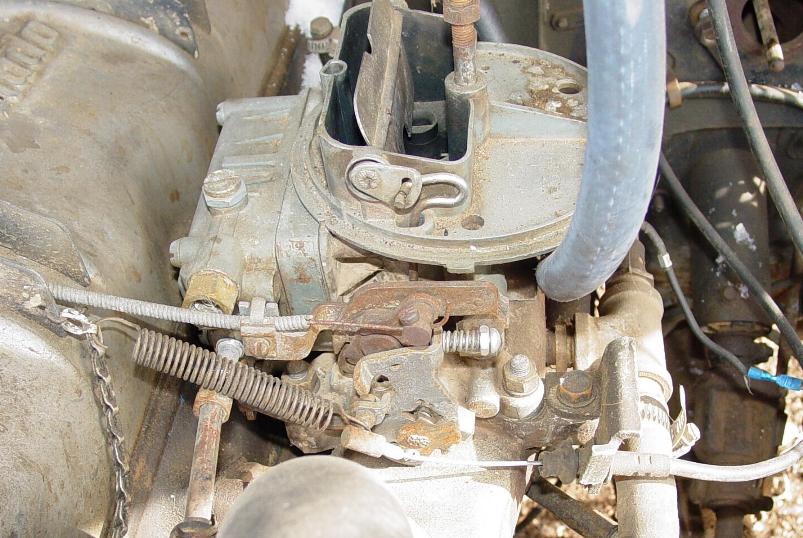

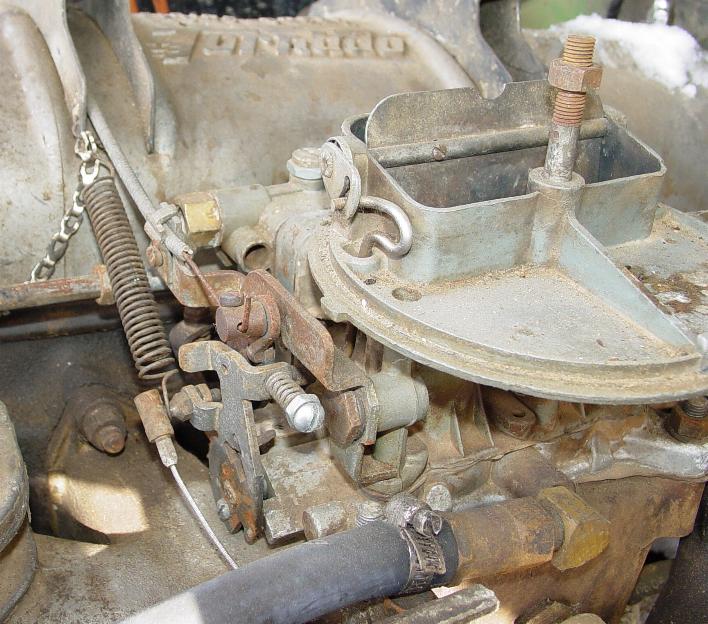

So I've been looking around on the zone trying to piece together what I'm really going to need to do to switch over to the civy intake and 2bbl carb. There isn't one thread that puts all the info into one place...so from the sounds of it other than the intake and carb I'll need to...
1. either tap the intake for the temp sending unit or put a T in.
2.find a new air cleaner type or cut and weld the bottom of an astro (year? ) into stock air cleaner.
3. Adjust or reroute throttle linkage.
4. Maybe a longer choke cable.
Does that sound about like everything? Anyone that has done this have any tips or pointers for doing this swap?
