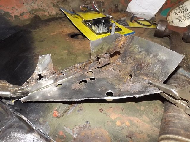

    I was going to treat with SEM and caulk stuff. But got a wild hair and put some more metal back. None of this was really visible. But I spent some time with a body hammer tapping stuff to see if I could knock anything loose. This must have been a low corner where it was parked.
    What I took out. Three pieces.
    What I put back. One piece at a time. This ought to last.

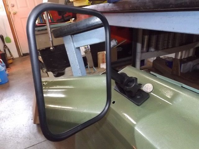

    I found some mirrors I like. I just need to make a new mount plate like what is there but the ears 90 degrees to what they are now. So the mirror will pivot back and forth, not up and down. Hit a branch with that and I will bend sheetmetal. I will probably make it out of stainless. Made by Rugged Ridge for tube doors on a newer Jeep JK or something.
    The business side. I like them.

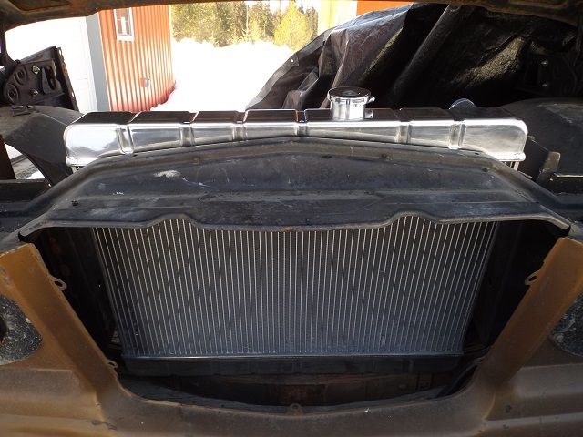

    That is the radiator that is a darn near exact match to my wagoneer 4 row brass and copper radiator for my buick 350 in the wagoneer. Since I am running a Buick 350 in the M truck, this should fit well. I was hoping to keep my front frame braces. I would have used the same radiator Scassidy used. But I plan on some hardcore firewood tree winching and wanted to keep them. If I have to cut them out later so be it. But looks like I will have 1/4 to a half inch top and bottom. There is about 3/4 to 1 inch on each side. Plenty of room.
    They claim 30% thicker tanks. Probably good for bumpy roads later.
    Black paint ready.

    Under the hood with it closed.
    Hood open. The radiator will be mounted about a half inch higher. It is sitting on a leaf spring for the pic. They could shorten the filler neck a bit. It will still fit. I will have to make mounts.
