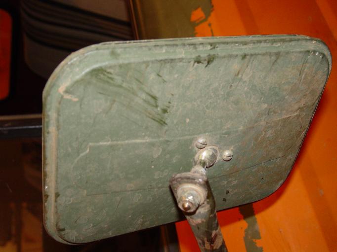

    The stock mirror is a rectangular mirror that has a single stud on the rear that is threaded and mounts to an adjustable mount bar that bolts to the door. The stud in the back of the mirror piviots on a ball with 3 screws around it to adjust the tension to keep it from slopping around. I have found them in parts stores, usually chrome on occassion, but do not have a part number off hand.

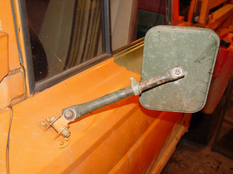

    I measured my mirrors and came up with 5 1/2 inches wide on both but one is 7 1/2 inches tall while the other is 8 1/2 inches tall...no idea why...
    The bracket on my doors has 2 screws that are side by side, not like the ones Stan linked to...try looking at this one...
    and here is a close shot of the back of one of my dirty mirrors showing the stud mount and screws:

    The bracket on my doors has 2 screws that are side by side, not like the ones Stan linked to...I know that VPW has the arms cause there the same as some of the Dodges...the mount bracket, I dont know for sure...
    brute4c
    Jon, I think yours are correct as my doors have the 4 holes. I have no idea where the ones that are on my M came from, they were on it when I got it. Either way I don't think the early CJ mounts would work very well.

    Ditto on the CJ ones...actually mine are basically a piece of shaped and drilled angle iron...would be pretty easy to make...
