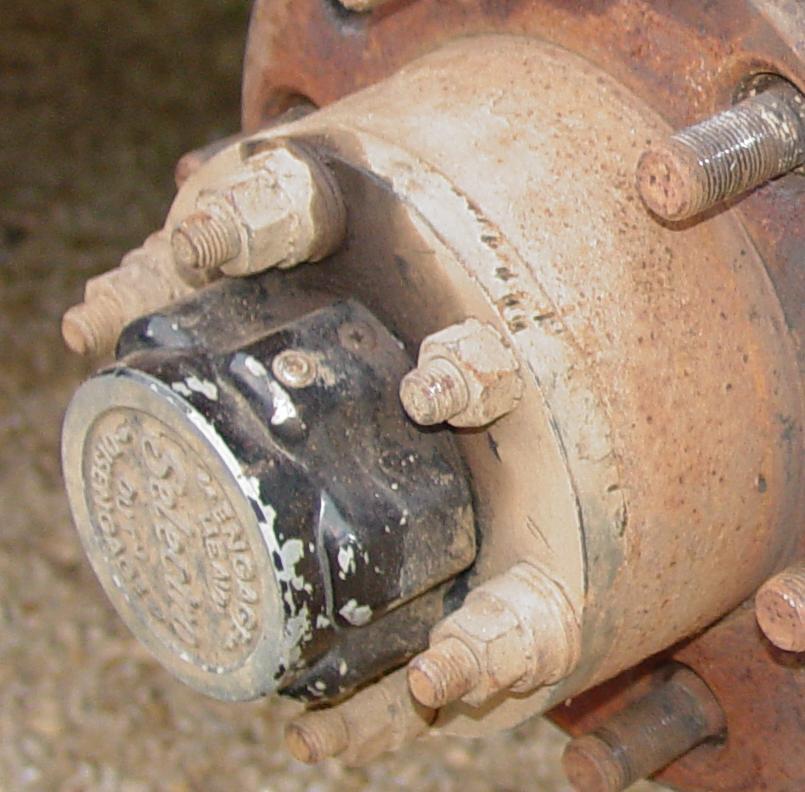

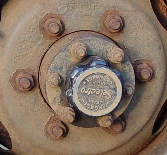

    If you leave the studs, the knob on the hub is harder to turn as the studs are in the way of getting a geat grip...you can get a finger/fingernail between a stud and the knob...I know...I left the studs. You can get a decent grip, you just have to be careful.
    I found a couple shots...these are from right after my brakes caught fire while flat towing so disregard the peeling paint and discoloration....
    You can see the short studs arent too bad, but the long ones, the ones that the towing hub is mounted on, are getting out to the end of the Selectro.
    Smile I see..............
    Whew...........
    I can see that it might be a finger ripper alright............
    Now do I attempt to get the studs out or not...
    I'll bet trying to get those studs out after 40 years is a bugger
    Thanks for the explanation and for the pictures ...... it's worth a thousand words....
