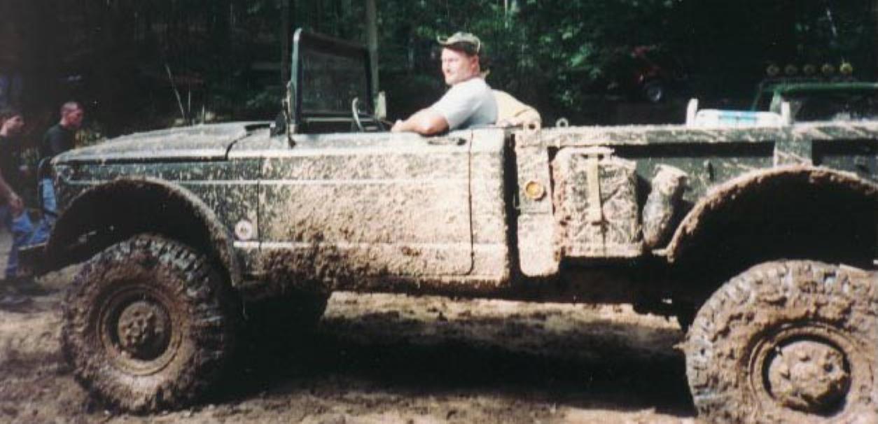

I found this shot...you can just see the back opening of the cowl:
IIRC he didn't add anything to the hood, just cut back the original metal at an angle.
