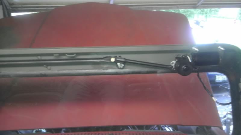

    YJ wipers in, I just need a switch. Still need another quart of resin to finish the fan shroud
    Thanks, George
