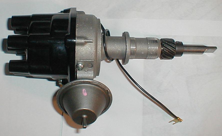

    Kalikraven sent me a pic of the distributor NAPA is selling that is the WRONG one...they list it for the 230 engine, but this is the 199/232/258 engines distributor, NOT THE 230's. NAPA also lists it under the correct engines. NAPA part number is NRD481646.
    And here is the only shot I have of the HEI distrib setup for the 230 engine...you can see from the length of the shaft that this is NOT going to clear the stock fuel pump...
    Hope this helps end some of the confusion...
    brute4c
