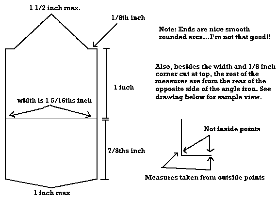

    OK, here is a simple drawing without the bolt holes, yet, of the angle piece...it would be easy to make out of 1 1/2 inch wide 1/8th inch thick angle iron. It has 2 screws going through the short end of it into the door and 1 bolt going through the longer, upper end, to the part that clamps the arm on. I noted the ends are rounded, not pointed like it shows...dont have an easy way to do that with this program so screw it...I made the dimensions, with the onscreen ruler, to be twice actual size. Remember it folds in the middle...and while I was looking at the door and measuring, I noticed the lower one on the door is a true 90 when mounted...the upper is opened up wider than 90...didnt measure how much....but it is exactly the same piece as the lower...it just opened to meet the mounting locatins on the door and the arm clamp.
    Let me know on you guys screen resolution, if its legible....mine is jacked up to the sky, so its hard for me to tell...
    And dont bother telling me I am no Michelangelo....I have never progressed past stick people so this is about Sistine Chapel quality for me already!!
